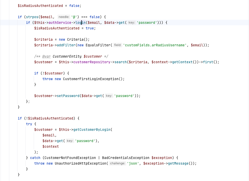

A separate plugin was developed for using the university's internal Radius server for logging into the workshop shop. The library by Drew Phillips (https://github.com/dapphp/radius) was used as the Radius client. The server connection could be fully customized via the plugin configuration in the administration area. To avoid a separate login, the default login in the frontend was adapted to also allow usernames instead of emails. All links for registration were removed, as registration via the storefront should not be possible. The class "Shopware\Core\Checkout\Customer\SalesChannel\LoginRoute" was used to adapt the login process, as no suitable events were available.
Authentication Radius Server
In the "login" function, it was checked if there was no email in the email field. In this case, the data was checked on the Radius server. If the user was successfully authenticated by the Radius server, the customer was loaded from the shop database based on the user name stored in the customer's CustomFields. If the customer did not already exist in the database, an error was returned that led to a modified registration page in the storefront. For this, the controllers "\Shopware\Storefront\Controller\RegisterController" and "\Shopware\Storefront\Controller\AuthController" were overwritten.
On the registration page, the student only had to complete their name and adjust the email address (by default, the student email address was used). The automatic registration then took place. Once completed, the student could log in either with their student account or normally with their email address.
