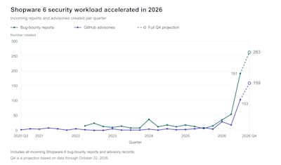

Security updates have always been part of running an online shop. However, the number of security reports we receive and the pace at which attackers act on disclosed vulnerabilities have changed considerably. That has consequences for how we develop Shopware, but also for how extensions are maintained and production shops are operated.
Our own reporting data helps explain why we are strengthening these efforts. The following chart shows Shopware 6 bug-bounty reports and security advisory records created over time.
These figures include unpublished advisory records and do not represent distinct confirmed vulnerabilities; reports and advisories do not map one to one.
The increase in findings does not tell us how many shops are affected or compromised. More reports do not, by themselves, show that the software has become less secure. They show that more potential weaknesses are being reported and investigated. AI-assisted research can uncover vulnerabilities that likely remained undetected before these tools became available.
However, those tools are available to attackers as well. If a security researcher can find an issue with AI, we have to assume that a bad actor may independently find it too. Responsible disclosure therefore cannot be treated as a period in which only the researcher and the vendor know about a vulnerability. The time available to investigate, fix, and deploy protection may be much shorter, even before an advisory is published.
Once an advisory is public, we already see automated exploitation attempts within days. So both parts matter: acting quickly on incoming reports and getting the resulting protection into production promptly.
