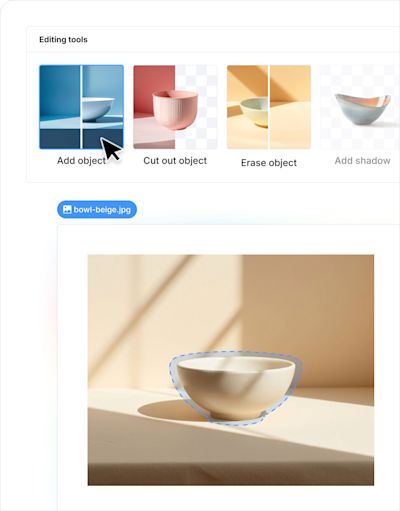

Shopware’s Image Editor lets you transform product images with AI, with extended usage available through Shopware Intelligence+.
We are also looking at how Shopware can support merchants with images generated outside the platform, where the responsibility for appropriate disclosure may sit with the merchant. This work is still ongoing. As the product approach becomes more concrete, we will share further details on how Shopware will support AI image transparency across generation, editing, media management, and the storefront.
