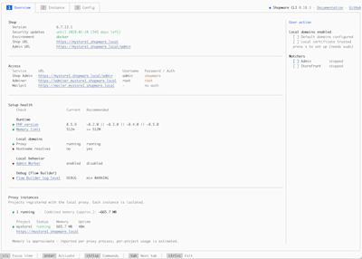

One Overview for the local environment
The project dev Overview also benefits from having stable addresses.
It can expose the storefront and Administration URLs alongside links to development services such as Adminer and Mailpit, combined memory usage, and health information for the local environment.
Watchers receive their own predictable hostnames as well. For example:
  1. admin-watch.<shop>
  2. storefront-watch.<shop>
This means the proxy is not only routing the main Shopware application. The surrounding development workflow can use the same hostname-based model.
